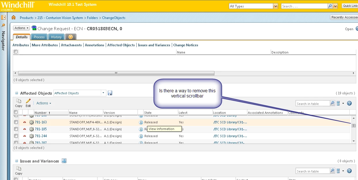

Windchill 10.1 - Scroll Bars
Is there a way to remove the scroll bars permanently from particular tables in Windchill 10? My user community is tired of stretching the tables, in order to view all content - in this case it is Affected Objects on the change request.
[cid:image001.png@01CF33C9.F8620450]
Thanks in advance,
Preeti
February 27, 2014
Click bottom of table and drag table to be much bigger vertically?
February 28, 2014
Yes 🙂
Then it remembers the table height, and display extra white space when there is only one object. I would like to remove this vertical scroll bar.

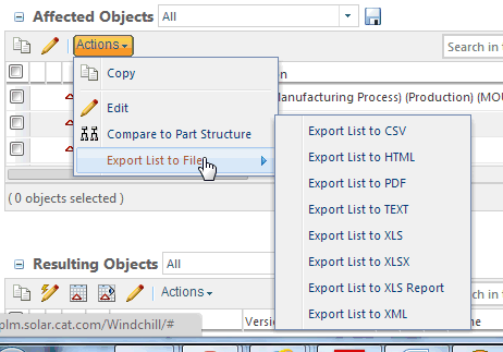

I would encourage the use of Actions-->Export List to HTML or some other
format. That will all be on one page, or even in excel for filtering.
