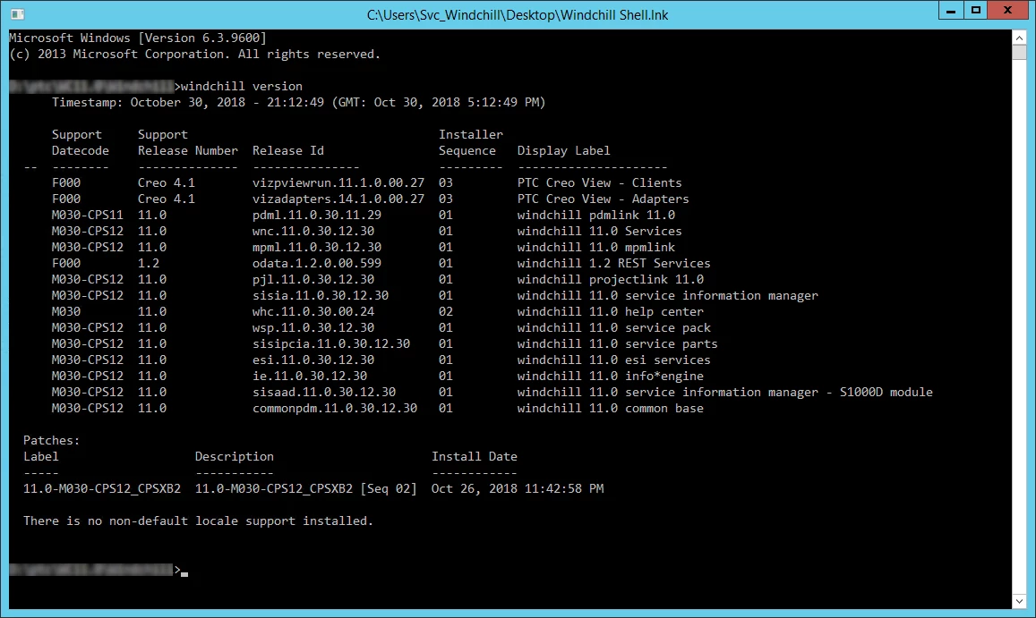

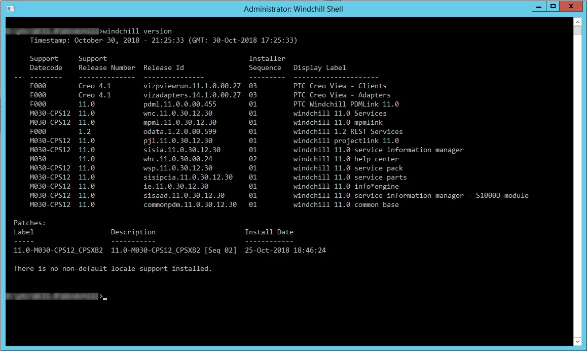

Windchill 11.0 M030 CPS12 showing different versions of components in different scenarios!
We're using Windchill 11.0 M030. Strange thing noticed after testing CPS12 is;
Windchill 11.0 M030 CPS12 OOTB installation and Windchill updated from 11.0 M030 CPS10 to CPS12 are showing different versions of components
Screenshots are attached here. Any idea why? Will this have any issue in future if production is upgraded to CPS12? A PTC case is also opened to see if it is something we missed during CPS12 update.

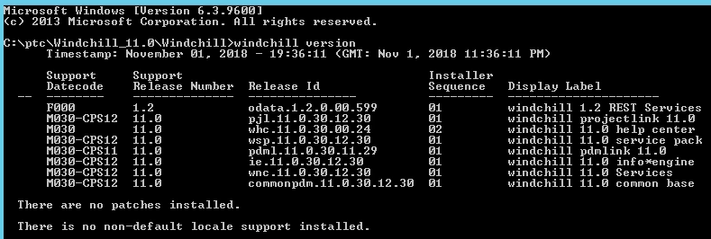

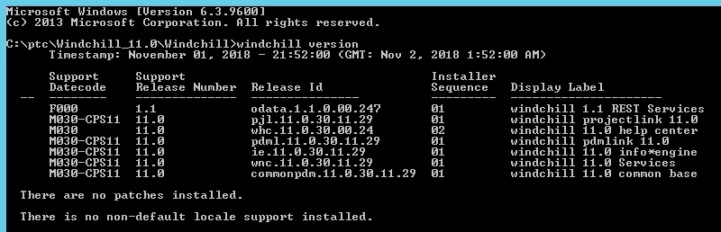

TomU
Nov 2, 2018 3:46 PM UTC
Clean install of 11.0 M030-CPS11
Same 11.0 M030-CPS11 system after updating to CPS12
Clean install of 11.0 M030-CPS11 using the CPS12 installer

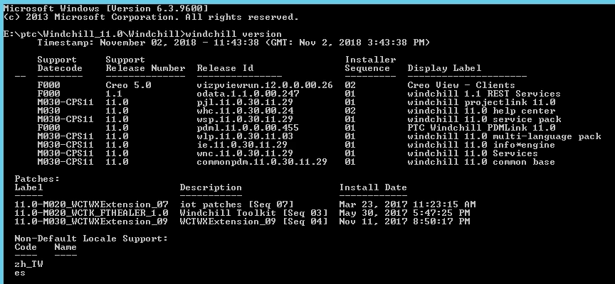

I'm getting ready right now to apply CPS12 to another system that was originally installed using F000 and has since been updated to CPS11.  Here's the before picture:
