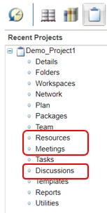

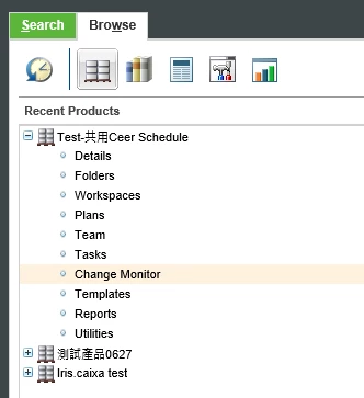

Windchill 11.0 [Product]&[Project] module, Why user can not see the 'Resources' menu? How to config?

The users also can not see [Porject] module,unless add theirs accounts to administrator group,then they will see the 'Resources' menu under [Product]&[Project] module. So I doubt if it is limits of authority ?
