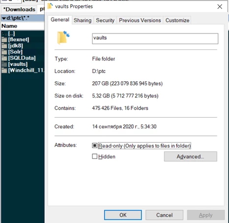

October 29, 2021
I use NTFS deduplication & compression in a production environment for vault, and have 97% space savings (200GB of data takes up only 5GB of physical space). A work with it during > 2 years. It works well.
