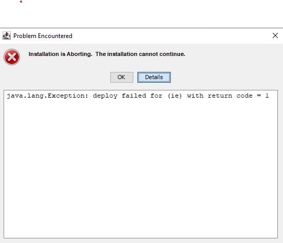

Windchill 11.2 installation aborts as "installation is aborting"
PSI shows this error in detail and installation fails.Screenshot 2022-12-26 130353.png
java.lang.Exception: deploy failed for (ie) with return code = 1.
I have attached a log file generated also please someone help me with it.

Please refer to article https://www.ptc.com/en/support/article/cs338740

I checked that article, and my system specifications are appropriate and still I am getting this error message.

The other possible reasons:
  • The password of the WindchillDS administrator cn=Manager contains special characters e.g. @,*,$.
  • The Info Engine installation media is corrupt. Download new CD from PTC ESupport
  • https://www.ptc.com/en/support/article/cs355004 (This only for reference. currently, from the attached log, should not relate this issue)
