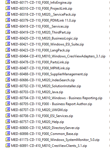

Hi Ben,
I have downloaded all the CD for my installation.
Most of them are only for build F000 because were not updated for M020.
See attached image.
Marco
BenLoosli23-Emerald IIIAuthor
Dec 6, 2016 5:41 PM UTC
That is typical for Windchill products. About half of the distributions stay at F000 and the update is handled by code segments in the Service Pak and Installation Installer discs. Other than those, most of the build discs are auxiliary products to the main Windchill codebase: Help files, WindchillDS, Index Search, Third Party apps, etc. All require 'patching' for the latest build of Windchill but may not be PTC developed code.
