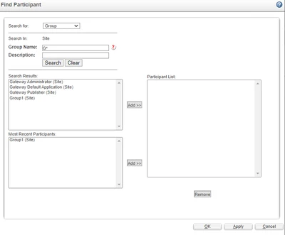

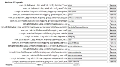

So for me, I did a brand new install and configured WC 12.0.1 with AD.
And I can search the groups and users from AD
Here is my JNDI Adapter mappings:
