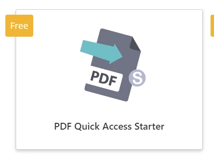

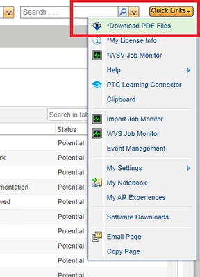

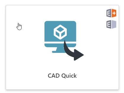

There are two extensions available Please go to https://windchill-extensions.ptc.com/
PDF quick access is free and CAD Quick is paid.
For CAD quick we did similar customization to download CAD.

Ajit - Thanks for the information. We're still on Windchill 11.0, there doesn't appear to be Windchill platform installer for 11.0 anymore.  Looking at the documentation/instructions at one point there was an installer for 11.0.  The PDF quick access starter is available for 11.0.  Looking on the PTC support site don't see any info regarding a platform installer for 11.0
