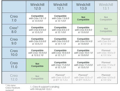

Windchill 12.1 compatibility with Creo 12
I am using Windchill PDMLink Release 12.1 and Datecode with CPS 12.1.1.1
Given that WIndchill 12.1 will go EOS in 2025, just wondering Creo upcoming 12.0 will still run on our current Windchill 12.1.1.1 or is upgrade to Windchill 13.0 required? Thank you. Edwin
avillanueva
23-Emerald II
Apr 24, 2025 10:50 AM UTC
It looks like they plan 12.1.2 so you would need to upgrade and you might as well jump to 13.
https://www.ptc.com/support/-/media/support/refdocs/Creo_Parametric/compatibility/CreoWindchillCompatiblityRoadmap.pdf?sc_lang=en&source=search

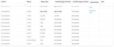

Apr 24, 2025 6:36 AM UTC
I have referred PTC product matrix on this link:
https://support.ptc.com/cs/release-calendar/index.html?productIdList=30
In the Creo Parametric section for the version 12.0 the details are not updated yet.
But you can refer above link to check the compatibility by clicking on the "View Page Matrix"
Edwin3-NewcomerAuthor

avillanueva
23-Emerald II
3-Newcomer
Apr 24, 2025 5:57 PM UTC
Thank you. I couldn't find this matrix 🙂
