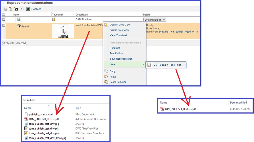

Just upgraded to Windchill 12.1 and I'm noticing an odd issue when additional files are downloaded from the representation.  For some reason Windchill (or Apache) is dynamically replacing every space character with a plus sign (+).  The additional files themselves do not include the plus sign in their names, and this can be seen by downloading the entire representation.  I dug through the preferences thinking maybe this is something new, but I'm not finding anything.  Please let me know if you have seen this before or have any idea what might be causing it.  Thanks!

         This is due to a code change in class:  com.ptc.windchill.enterprise.wvs.repsAndMarkups.commands.ListRepFilesController
Within the download URL which constructed by the class:
  • Before 12.1  ----  var filename = filename
  • start from 12.1  ---- var filename = URLEncoder.encode(filename,"UTF-8")
Replace the class by the one from a previous release could temporally workaround this symptom, however, is not officially supported.

Thanks.  That's more than I've heard from tech support so far.  Not sure why filenames need to be 'URL encoded' on this one particular page...

       In some rare scenario, for example, whenever a filename is something like "xyz-balabala%.pdf"  (filename has a '%' just before the '.') then without the 'URL encoder' method, such data will be failed to be downloaded.  Considering in most of time, chance of such case is very small, so no worry about this new updates.

For those who may be interested, an SPR has been filed and a corresponding KB article created.
https://www.ptc.com/en/support/article/CS371226
I was able to use a class file from a 12.0 system to get around the issue for now.
