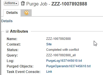

Feb 22, 2023 3:08 PM UTC
This is what I see. It shows a list of the purged objects. What is missing?
TomU
Feb 22, 2023 3:15 PM UTC
Is that from 'Purge Management' or 'Audit Log Purge Management'?
I"m on 12.1.2.0 and I'm not seeing anything useful on the 'Audit Log Purge Management' screen...
avillanueva
23-Emerald II
Feb 22, 2023 4:08 PM UTC
my bad, Purge Management, Doh!
