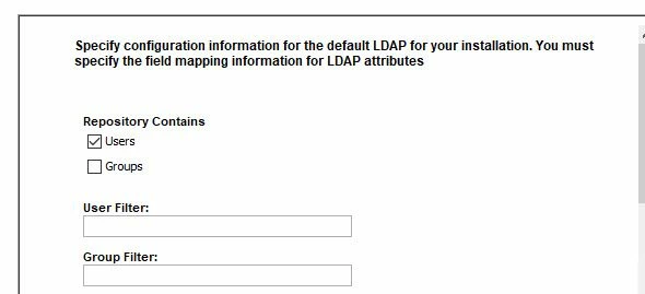

This is the first time I'm installing WC 12.  for the Repository Contains, Users is prechecked but Groups is not.  If I am doing an upgrade from 11.1, should I also check the Groups box?  Do I need to do anything with the User and Group Filter?

When I upgraded from 11.1 M020 CPS22 to 12.0.2.3 I did the following:
  • Users: checked
  • Groups: Unchecked
  • User Filter: uid=*
  • Group Filter: cn=*
    • Actually could have left blank

I have always just left that with the Users check and no filters.
But I have not done a Windchill 11.1 upgrade, just a 11.0 upgrade.
My 11.1 upgrade testing starts in 2 weeks.
My 11.0 system uses groups differently than my 11.1 so I may have to rethink this.

@BenLoosli, I have three different systems to upgrade and one uses groups extensively in workflows.  This one doesn't, but should in the future and I want to try and get the three as close to each other as I can from an admin point.

My 11.0 system was set up by the prior admin and has been upgraded from Windchill 8 to 9 to 9.1 to 10 to 11. He used DS groups. When I set up the Windchill 11.1 system, upgraded from 11.0, I used Wihdchill  groups.
That may be why I will need to check the Groups repository for the 11.1 upgrade.

@RandyJones, is the User Filter necessary?  What does that do?  I am curious because Ben hadn't used it.
I am going from 11.1.2.28 to 12.1.2.0.
