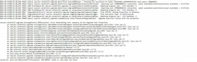

WINDCHILL 12 UPGRADE MANAGER FAILS IN INITIALIZE UPGRADE
  • October 16, 2024
  • 589 views
Version: Windchill 12.1
Use Case: Hi, I'm having difficulty at the initialize upgrade stage. at that stage the SAVING PROPERTIES DATABASE task failed. when I checked the log it gave an exception: "Error determining next sequence id for upgrading user Properties" cause "ORA-00942: Table or view doesn't exist". I checked the table in question in the log, namely table: WTUPGINST_USERPROPERTIES which doesn't exist. When I checked my schema database, the table was there and there were no problems with the Grant Privileges, it was in accordance with the provisions. I appreciate any answer.
Description:
October 16, 2024
You have asked a technical question in a community forum. This is a forum for users to help users.
For an issue like this, you need to open a call with PTC and let one of their experts in UpgradeManager handle the issue.
