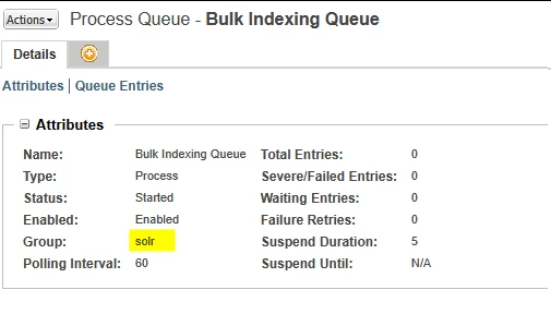

Hi there,
after successfully Installing Windchill 13.0 including working Solr-Server and working “search” within windchill, I migrated my data to that new location.
all issues in upgrademanager were solved successfully.
I can accesss my files and all data is shown.
I even can checkout files with Creo Parametric and check them in again.
But Indexing does not work at all.
Solr - Server is running. I can login via http://localhost:8085
Credentials for solr are set in Windchill via
xconfmanager -s wt.index.solrAdminUser=<User> -t codebase/WEB-INF/conf/index.solrAuth.properties -p
xconfmanager -s wt.index.solrAdminPassword=<Password> -t codebase/WEB-INF/conf/index.solrAuth.properties -p
But queue is not starting.
The number of “remaining items” is stuck at 20k+ items, the number of processed Items is stuck at zero
( Site → Utilities → Indexing Administration ).
I tried “windchill wt.index.BulkIndexTool” in windchill’s hell and I got this:
Core 'wblib' is selected.
Exception in thread "main" wt.util.WTException: An exception occurred while attempting to start the queue
at wt.method.RemoteMethodServer.invoke(RemoteMethodServer.java:823)
at wt.index.BulkIndexHelper.startBulkQueue(BulkIndexHelper.java:299)
at wt.index.BulkIndexTool.processStart(BulkIndexTool.java:508)
at wt.index.BulkIndexTool.processOption(BulkIndexTool.java:570)
at wt.index.BulkIndexTool.processAction(BulkIndexTool.java:207)
at wt.index.BulkIndexTool.run(BulkIndexTool.java:165)
at wt.index.BulkIndexTool.main(BulkIndexTool.java:86)
For the records: There is no working “CAD worker” yet.

It turns out, that at the source system, there was a dedicated BackgroundMethodServer for Indexing.
After changing that group back to “Default”, Indexing starts to work again.
For performance reasons, I should figure out, how to get this second BGMS started.

Objects are indexed through the BulkIndexQueue. The exception tells that the system is unable to start the indexing queue.
Restart the BGMS and try again.
