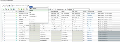

Windchill 13.0 Save As – Need Default “Reuse” for Library Parts Only
Version: Windchill 13.0
Use Case: A CAD Engineer is working on an assembly in Windchill 13.0. The assembly contains both: Standard Library Parts (e.g., screws, bearings, fasteners, etc.) stored in a controlled Library context. Design-Specific Parts that need to be copied for a new product variant. When performing Save As: The business requirement is that Library Parts must always be reused (to avoid duplication of standards). Only the design-specific parts should be copied automatically. Current challenge: Windchill sets either all dependents to Reuse (with preference “Enable Save Selected Objects Only”) or requires the user to manually adjust each dependent, which is error-prone.
Description:
In Windchill 13.0, when performing a Save As on a CAD assembly, the system does not provide an option to automatically distinguish between Library parts and non-Library parts.
  • With the preference “Enable Save Selected Objects Only” enabled, only the top-level assembly is copied, and all child dependents default to Reuse.
  • The requirement is to ensure that only Library parts are set to Reuse, while all other dependent CAD parts should default to Copy.
  • This leads to manual effort where users must adjust each child object in the Save As dialog, increasing the risk of errors and duplication of Library objects.
Impact: Without this functionality, standard Library objects may be unintentionally duplicated, leading to data inconsistency and confusion in product structures.
shussainiAnswer
Aug 21, 2025 7:16 PM UTC
Agree with Joe's suggestion. In the meantime, you can use a workaround. Although its manual but at least can eliminate the chances of duplication for Library parts. You can create a view which filters data based on location attribute being set to library name, Once you change to the library view, select all the parts and have set them for Re-use. Remove the selection and revert to the original view. Continue with the Save As.

shussaini16-PearlAnswer
Hope this helps.
regards
~Syed
SumA_ZF4-ParticipantAuthor
Aug 25, 2025 1:13 PM UTC
Thank you, it works for me

Hi @AKHILESH_YM need to go with Lisners and data utility - customization
Lisners for save as even and data utility to set the lib part to reuse. but the simple solution is suggested by syed.
