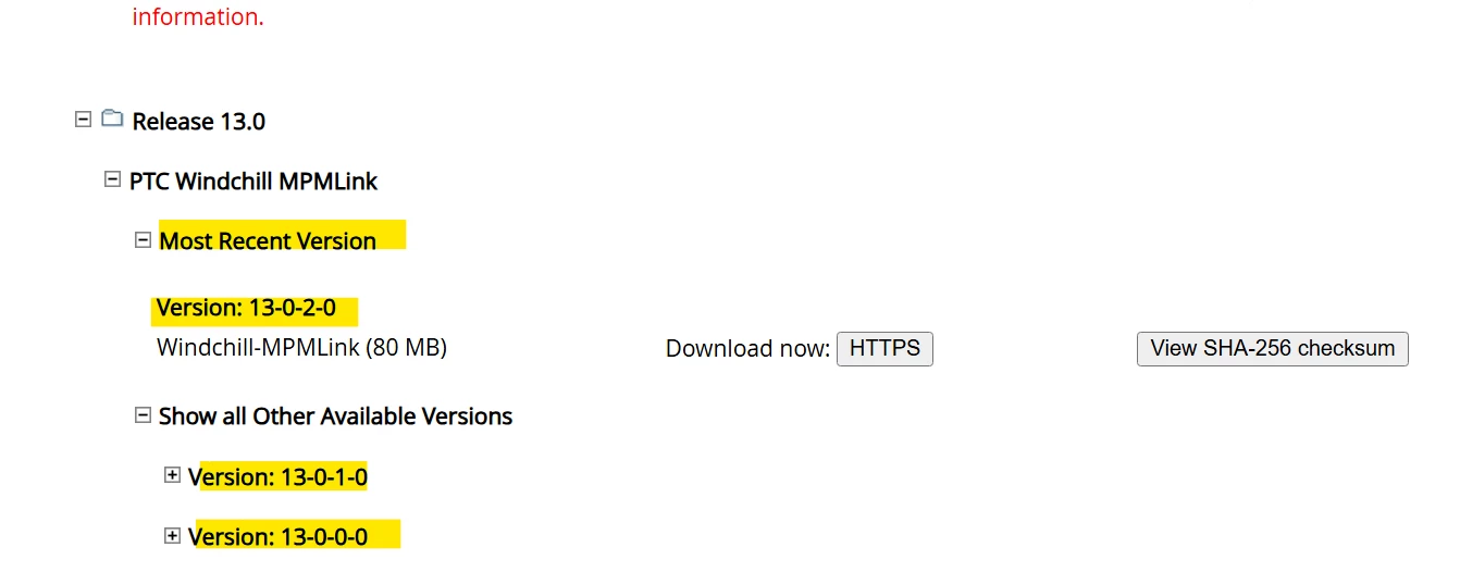

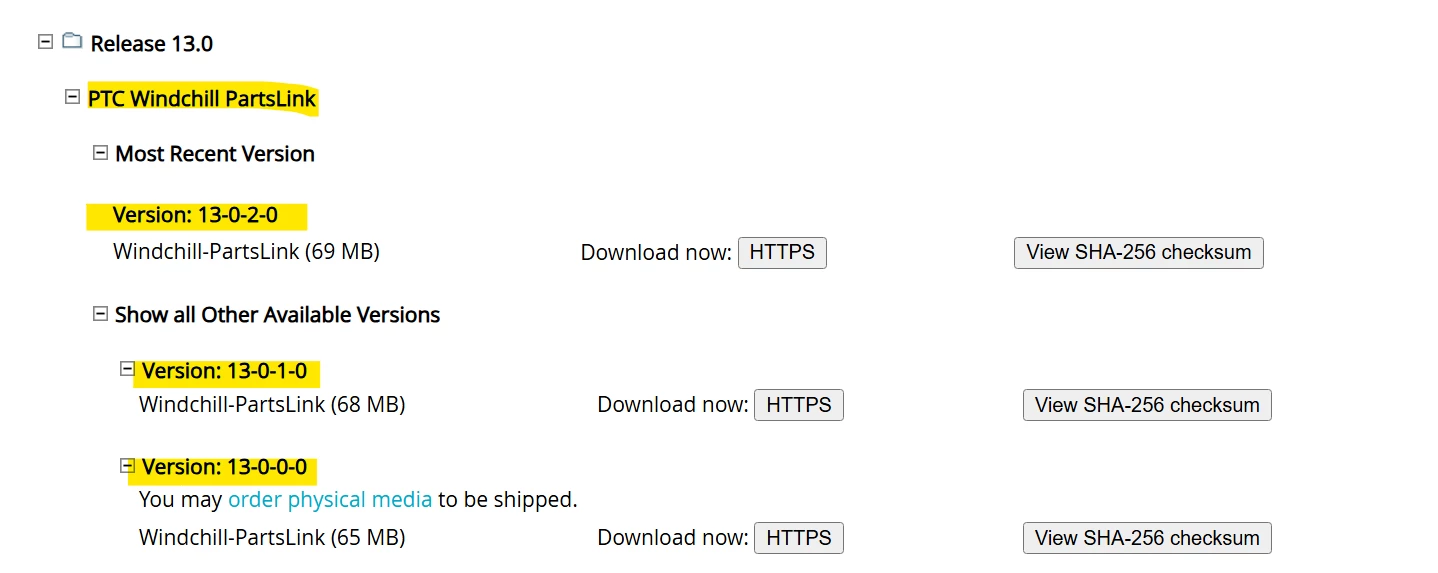

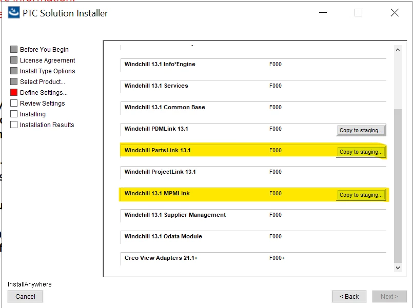

Hello Experts,
I am installing the WC 13.1.0.0 on windows server.
While installing the WC at end steps it was asking for Medica kits to be copied to staging area.
It was asking for the "Windchill 13.1 Parts Link " and "Windchill 13.1 MPM Link" media CD. When I checked that on PTC site I am not able to find any relevant Media on site.
Please see attached images for reference. Has nay one faced this issue?
If you have any idea where to check. Please let me know where we can find the latest software media for above mentioned modules.

Apr 1, 2025 6:39 PM UTC
Strange I cannot see 13.1 in listing at all. I believe it should be there since you have it in your images.

Apr 2, 2025 10:51 AM UTC
It seems the mentioned medica files was not enabled for my company. Post follow up with PTC missing software CD medical made available by PTC license and support team.
