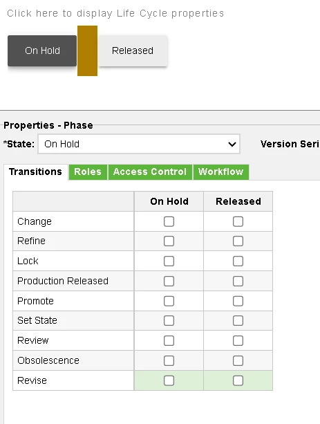

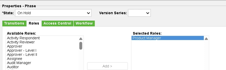

Below is an example of the setup.
Lifecycle (advanced)
Workflow
then once setup the role will be automatically assigned to the product managers and the WF timer Starts.
The Document Template will have the instructions to follow (if you ever need to change them just update the template for next time
The Timer will wait for X days
Then send the task
Doc Template has the Tasks. one of the tasks is to create a new Doc review from Template
Using asses controls you can hide the doc review subtype from other users.
The history and the document metadata give you your audit trail .
hope this helps

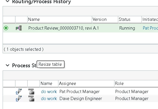

Sep 2, 2026 9:26 PM UTC
Interesting,
Create an advanced lifecycle with a workflow that has a timer. Attach that to a document subtype that has the instructions for the product manager to follow. Once the product manager has completed the tasks, part of the instructions tells them to create another document from template.
All notifications can be created in the task.

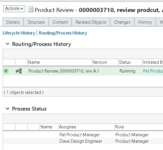

6-Contributor
Sep 3, 2026 4:10 AM UTC
Thanks, this sounds like an interesting approach.
Just trying to understand one thing here. how do we identify all the Product Managers and send the task to each of them?
And once everyone completes their review, is there any way to track who has completed it and who hasn't? kind of audit we can do
Also, the document created from the template after the review — is that supposed to be the confirmation that the Product Manager has completed the review?

BryanK17-PeridotAnswer
Sep 3, 2026 11:02 PM UTC
Workflow
Then send the task

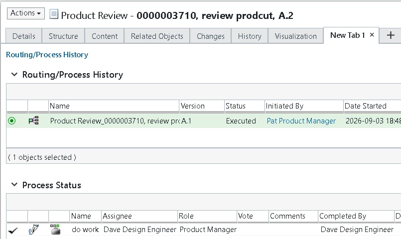

hope this helps
