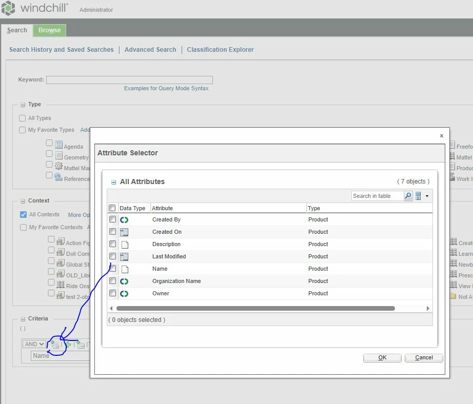

windchill advance search filters
Version: Windchill 12.0
Use Case: Why Attribute selector values in Advance search criteria differ from user to user
Description:
I noticed Attribute selector values in Advance search criteria are different for users. How it is controlled. Refer attached image

Attributes that are available are directly related to the objects you select in My favorite object section. Since this is a sticky setting, perhaps those users have different set of object types being returned. Try select one object like WTPart or WTDocument. They should be able to see the same set of attributes then.

The attribute set depends on a object type selection. Each user can check different type
