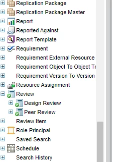

I am looking to create a Peer Review on a document or a dynamic document. The following link/post seems indicate the Windchill 11.0 software will be able to accomplish this task.
https://community.ptc.com/t5/Windchill-Questions/Peer-review-of-documents/td-p/545404
However, the post seems to speak to the Windchill 11.0 M030 release. I followed the steps and I noticed that I do not have the 'New Review' option from the context menu. I checked the version I am running and the release version is Windchill M030-CPS06.
Any suggestions?

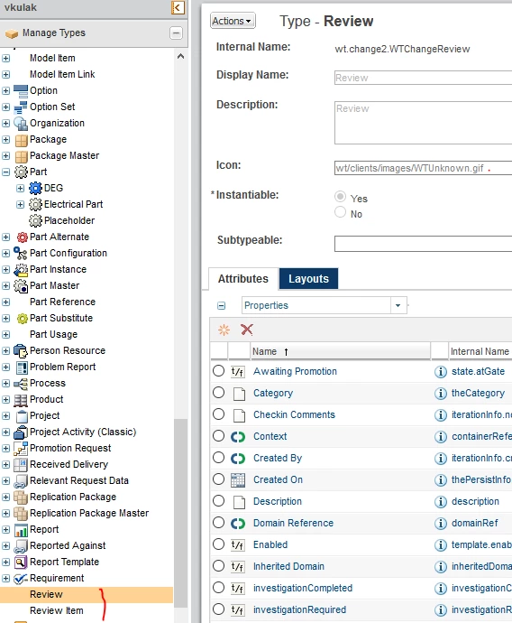

You are not alone
I'm in the same case ( 11.0 M30 CPS 8 ) and no action menu.
I suspect an upgrade problem because i have the object but with Unknown icon.

All,
You might have to have a license for it.  We use it here at my work. I am actually about to do a webinar presentation on it for our 30,000 Windchill users later this month. It is listed after Requirement.
