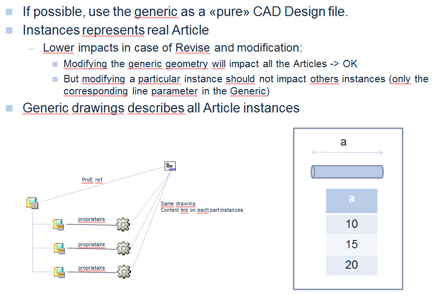

Another rules.  If you use WTparts and BOMs in windchill with CAD Integration
Do not use the Generic as a "real part" (eg never linked it to a Wtpart). The Generic have to be used as a "pure Design model"
Because if you need to update de FT, or add new instances, it will impact the Wtpart even if not mandatory from a WTpart/BOM management point of view

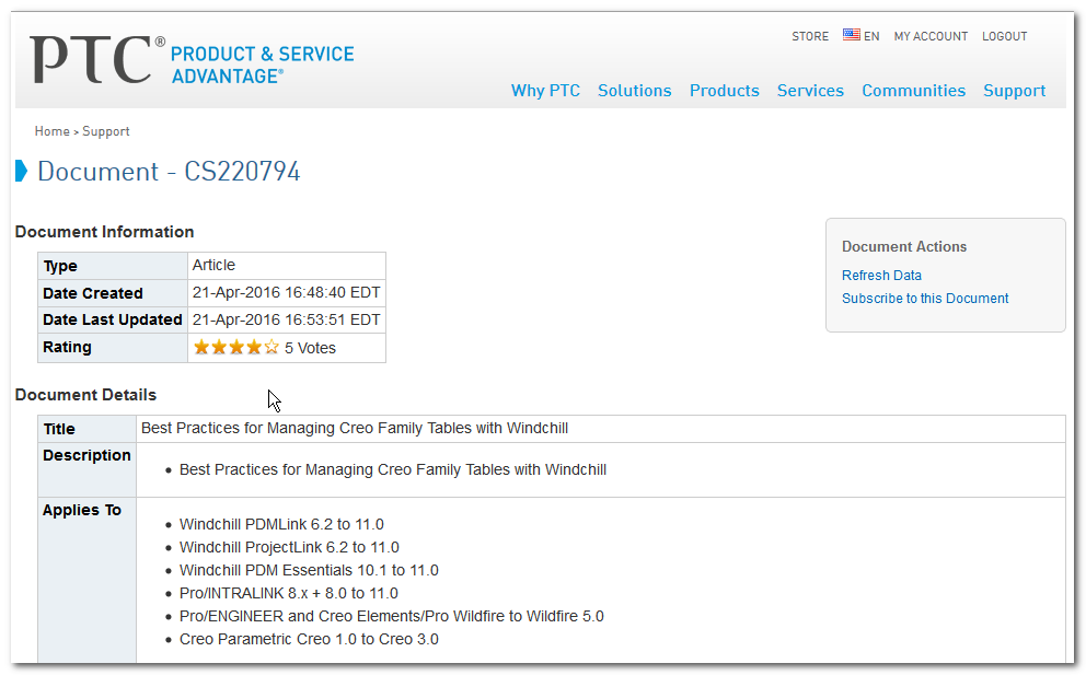

I ran across this in my feed today:  http://support.ptc.com/appserver/cs/view/solution.jsp?source=subscription&n=CS220794
(You will need an active PTC account to access.
