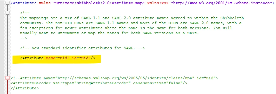

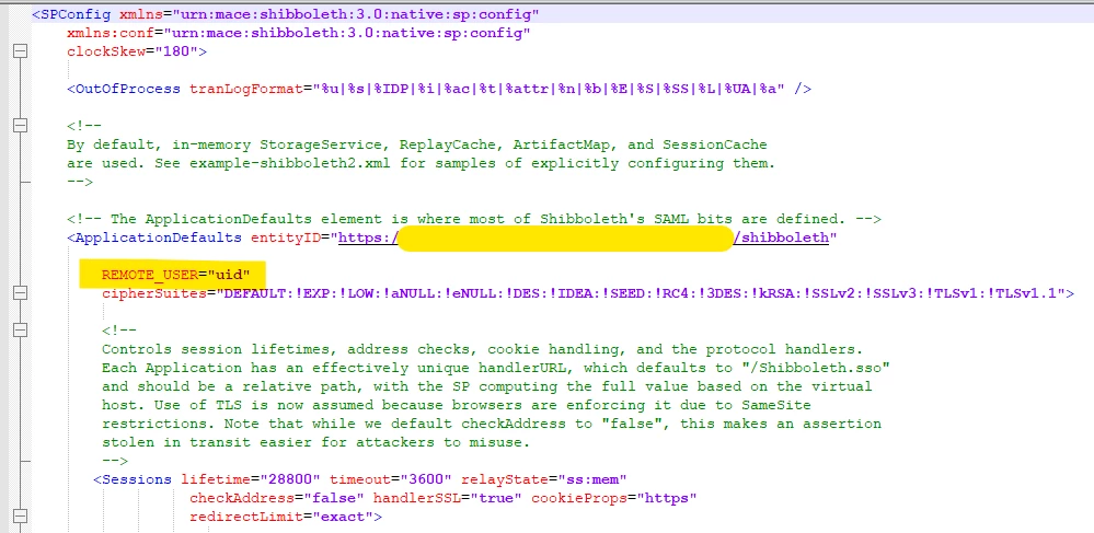

After SSO configuration, Users can access windchill UI page but getting an Authentication error while doing load commands.
Example:
windchill wt.load.LoadFromFile -d <path to xml> -u <username> -p <password> -CONT_PATH \"/wt.inf.container.OrgContainer=<org name>\"
The operation: "getPrincipal" failed.
Nested exception is: wt.util.WTRemoteException: Unable to invoke remote method
Nested exception is: wt.method.AuthenticationException
Method server log:
ERROR [RMI TCP Connection(1797)-10.219.4.138] wt.httpgw.HTTPAuthentication - HTTP login failed: client host = xx.xxx.x.xxx
*But can load this successfully with wcadmin.

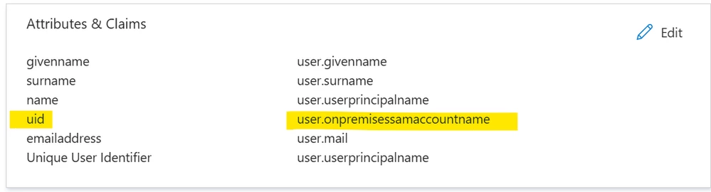

SSO Configurations:
Defined claims and attributes in idp (Azure AD)
Defined REMOTE_USER as "uid" in shibboleth2.xml file.
Defined <Attribute name="uid" id="uid"/> in attribute-map.xml file.
Windchill version 12.0.2.3
Shibboleth version 3.5.0
It seems users unable to authenticate.. If I'm missing something in SSO configuration, please let me know. Looking for response.
