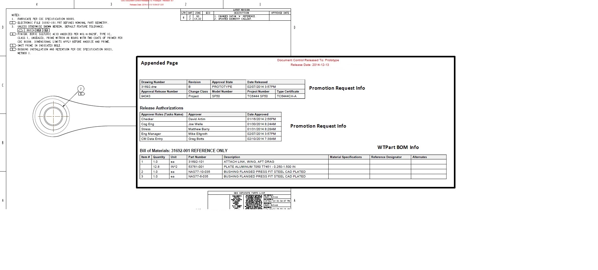

How did the E-BOM help us transform into a single data entry point and single drawing artifact in Windchill? Thanks to the presentation in Boston, System Generated Drawings, I was able to use their concept and apply it to our drawings. Today in our production environment when a drawing is published at the end of the release workflow we are extracting the approver task name and date from the promotion request and the WTPart E-BOM and automatically appending it to the last page of the drawing PDF.
See Attached Drawing Example
One small thing that has an impact for the mobile applications is that we are also generating a PDF with watermarks along with the auto appended  page and attaching it to the drawing object in Windchill as an attachment. Note: The mobile application does not allow you to view the Creo drawings, only 3-D Models, Microsoft files and PDFs. This was not acceptable for our use to justify the deployment of  the mobile apps. With the appended PDF of the drawings  the mobile apps become a viable piece of technology.

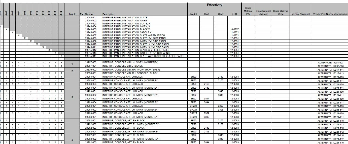

  3. How will Windchill handle each row and column of information currently documented on the Excel Parts List?
    1. Our parts lists were configured in a column format for tabulated drawings that could include one or more different configurations, Dash Numbers. In addition each item number could be expanded for multiple parts call outs for non-interchangeable replacements that were then defined by effectivity that specified aircraft serial numbers for start use and stop use of the discontinued/new component. Some parts list became a complex matrix that few individuals understood.
    2. Information such as; item #, quantity, part number description are common item on a parts list. The remaining information stock material usage, alternate parts, reference designators and effectivity start stop serial numbers became the difficult items to account for with our user base. (See Attached Excel spreadsheet Parts List)
      1. Windchill orders the parts numerically, not by item number unless you use Line Numbers

  9. Will we utilize Effectivity Management for non-interchangeable change (Part Number changes) in Windchill?
    1. Yes, effectivity was currently defined on our separate Excel spreadsheet Parts List. Utilizing Windchill’s Change Objects was the best standardized method for us to transition too.

Dissecting the System Generated-Appended Page (See Attached Drawing.jpg), The appended page is automatically created from 3 sources of Windchill data
  • Promotion Request or Change Objects attributes and approvers
    • Past process required end users to open the drawing, select the History Tab, Select the Authorization’s PR link, Select the Process tab and scroll down to the workflow task role approvers to find out who and when data was approved. By auto appending this information to the back page it acts as a single source of all required information mined from the system.
    • WTPart Structure
      • As seen in the attached drawing the Bill of Materials shows items 1, 2 & 3. In addition there is an undesignated line item. This is the material consumed to produce the subordinate part on this drawing. To account for the material which we wanted as part of the BOM for all subordinate part numbers but is structured one level deeper, and without showing multilevel deep BOM’s for other drawings that were not defined with a subordinate number we created a new Assembly Mode type called Material using the enumcustomize tool. Once this was designated we were able to script the auto BOM population on the system generated drawing to show only materials designated at a secondary indentation level.
      • Material Specification, Reference Designators and Alternates are also gathered with the same script and populated in a report view for the BOM that makes sense to most of our end users.
    • WTPart References Documents
      • Not shown on the attached drawing is a third table for all references documents. Any document associated to the WTPart in the Ref Docs area are gathered and reported in this table. This provides additional levels of where used and reporting functionality for supporting documents. We originally thought we would indent to the specification level but later determined this was not a good idea. BOM are only indented to the consumed item.
      • See Attached WTPart Structure compared to the Auto Appended System Generated Page.
      • In the future the Creo View Dynamic Watermarking can be reduced to only stamp the release state since all other information is redundant now that it is populating in the attribute table.
