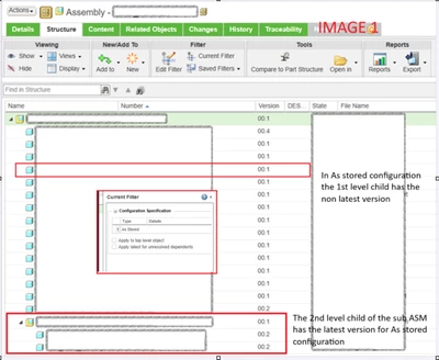

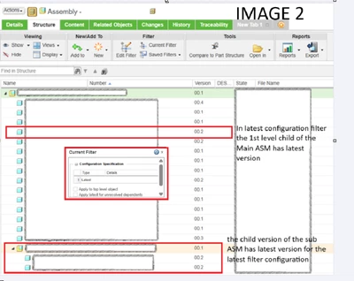

Use Case: In windchill 11.0 the CAD BOM the As Stored configuration filter is applied for the Parent assembly in which the 1st level child has the non-latest version, but the 2nd level child has the latest version for the Sub assembly instead of the non-latest version (as stored configuration)
Description:
Is the as stored configuration filter only applicable to 1st level child of the Parent assembly? Does the filter not take the as stored filter configuration for the 2nd level where the child is non latest, or does it always consider the latest filter for sub assembly levels? (refer Image 1 for as stored & image 2 for latest filter configuration)
