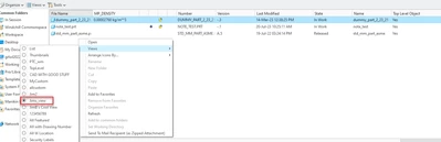

For the file>Open (workspace) issue...
  1. Create a custom Workspace View
    1. Note: view can be created by an admin, or the end users.
  2. RMB in the file>open window Views > Select the view created in 1
Aug 4, 2023 6:08 AM UTC
