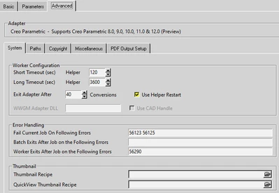

Use Case: A CAD model includes a feature whose geometry is generated from a text string that uses a particular font. Since the font isn’t installed on the CAD Worker machine, the worker silently replaces it with another font, giving an incorrect representation without any error notification.
Description:
Hi everyone,
I’m running into an unexpected behavior with the Windchill CAD Worker when publishing Creo Parametric models that contain text using a non-standard font. In our case, the model includes a feature whose geometry is generated from a text string that specifically uses this font. Since the font isn’t installed on the CAD Worker machine, the worker silently replaces it with another font. The publish job finishes successfully, but the resulting representation is incorrect and doesn’t match the original model.
What’s most concerning is that the issue isn’t clearly reported anywhere. The only trace is a single warning line in the trail file, but no error is raised, no notification is sent, and the publishing task appears to complete normally. As a result, incorrect published content can be generated without anyone realizing it.
We’re aware that the simplest fix this would be to install the missing font on the CAD Worker machine, but our IT department doesn’t allow this due to legal and cost-related restrictions, so that option is off the table.
I’d like to know if there’s any way to make the CAD Worker treat missing fonts as a real publishing error, or at least to surface the issue more clearly, maybe through some form of notification.

The users' config.pro and the CAD worker's config.pro are the same, and all users who use it for design have the font in the Windows font folder on their PCs.
We discovered the problem because one of our mold makers received an order to build a mold, having shared the family table instance with him, which was missing the extrusion feature that used the font missing in the worker, thus creating the mold without the lettering.
The font was chosen by our marketing department to reproduce the code of our finished product on the molded parts.
The cost of the font used by dozens of users is very low, while the license to use it on the worker would cost tens of thousands of euros, so we are currently looking for a way to intercept the problem before spending a substantial amount of money.
The peculiar thing about the problem was that the family table had two instances, but only one was missing the extrusion of the text, while the other had it.
After several tests with one of the Creo experts, we discovered another peculiarity, namely that the correct instance during model regeneration had this warning in the trail file:
Warning “This view has been frozen because of illegal view instructions.”
There is an article that explains the reason for this
https://www.ptc.com/en/support/article/CS272516
The regeneration of the instance where the font was missing did not have the same warning.
The first idea that came to mind was to modify the worker configuration by adding the font missing error code to the error codes that cause the publication to fail, so that the printer cannot see the incorrect representation in CreoView.
I have already written a comment on an article that contains a list of some error codes used in the configuration, asking support if there is a list with this information, but I have not yet received a response after a week, so we turned to the community.
