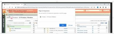

Windchill container folders page gets stuck/unresponsive and does not allow user to proceed further.
Here are the errors that I faced
Page unresponsive

Feb 9, 2023 4:30 PM UTC
This has something to do with the 'Table size limit reached' message. This banner typically fades away in few seconds or even allows user to close. But in this case, it just stays and freezes the entire page and eventually resulting in the error message.
The workaround here is to set the folder view to some object which results in 0 objects so that the table dont have to load any data and there by avoiding the error.

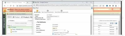

Feb 21, 2023 6:21 PM UTC
I face the same issue since I moved from 11.1 M020 to 12.0.2.8, This happens for me across multiple pages not just Folders. I have the same issue on Context creation and plans as well.
