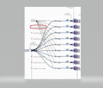

In Windchill, whenever I view my Creo drawings with the "Creo Lite" viewer, I keep getting datum features that show up on my drawing (see snapshot). Does anyone know what causes this? Is this a Layering issue because I do have my layers turned-off in the drawing?

I am assuming this is a Creo drawing. Add this to your worker config.pro. Stop and start worker and try again.
display_axes no
display_coord_sys no
display_planes no
display_points no
display wireframe
parenthesize_ref_dim yes
let me know if it helps.
Regards
Ajit
