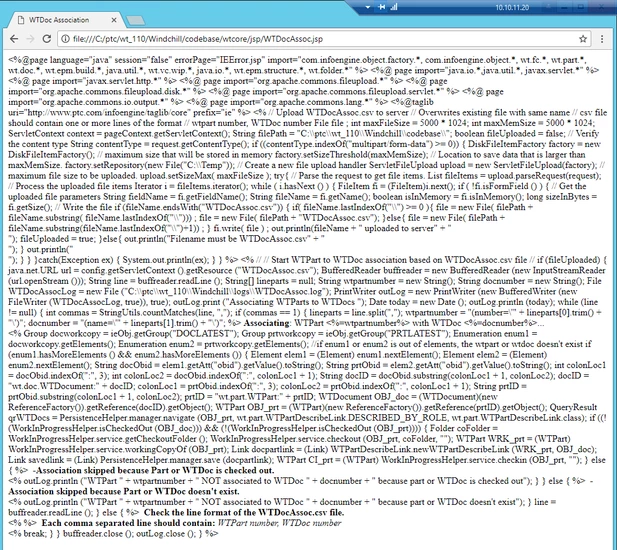

1. I've placed the html and jsp files under <WT_HOME>\codebase\wtcore\jsp
2. Modifed the file paths in the jsp file to match our Windchill installation
3. Created WTDocAssoc.csv with the two values; WTPart number, WTDoc number
4a. Open the html in Internet Explorer > Select the csv file in step 3 > Click on Upload File button
Nothing happens.
4b. Open the html in Chrome > Select the csv file in step 3 > Click on Upload File button
It seems like the jsp code isn't being executed at all. Any help is appreciated.

Like Darrell stated in his blog you have to access the code thru the web server. ie
http://YourWindchillServer.yourDomain.com/Windchill/wtcore/WTDocAssoc.jsp
Accessing by opening as a file, as you are doing in your screenshot, in a webbrowser will not work.

Hi Randy,
Thanks much for the reply, that did the trick!

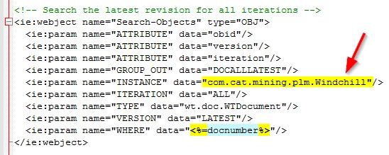

The code is being executed but now I'm getting an error message - "No such service: com.cat.mining.plm.Windchill" - which is in this line in the jsp file.
Would you know if the service name is different between 10.2 and 11.0, and if so, what the correct service name would be?

Darrell13-AquamarineAuthor
September 1, 2017
I updated the example code I attached to this blog originally based on @daraki's replies above. I can't attach it to this reply, so I had to make a new blog post. You can get the new files there.
