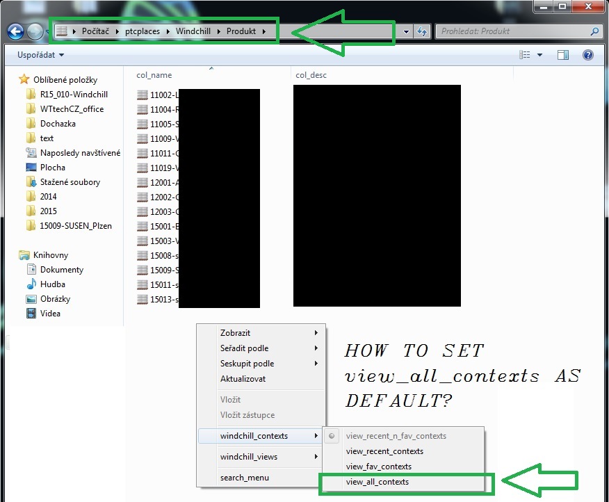

Hello all,
l have some basic problem with Windchill desktop integration. My directory settings is default set to "view_recent_n_fav_contexts" everytime l open COMPUTER ---> PTCPLACES ---> WINDCHILL ---> PRODUCTS. Is there any chance set it to "view_all_contexts"?
In generall: Is there any way how to config windchill desktop integration?

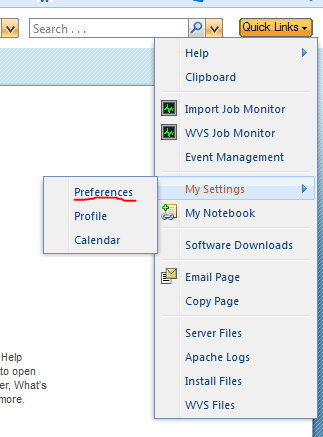

Hi Milan --
Yes! You can set this using the preference manager utility in Windchill:
From Windchill, go to Quick Links > My Settings > Preferences
The preference is available under Documents.

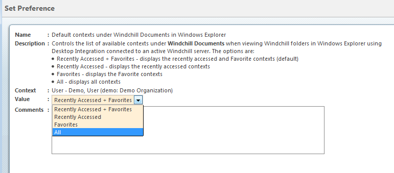

Right-click Default contexts under Windchill Documents in Windows Explorer.
Click Set Preference and set it to All

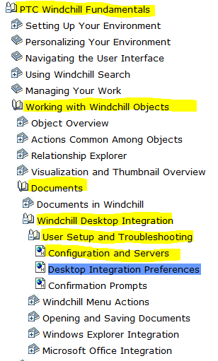

For information about all the configuration options, you can use the Windchill Help Center:
PTC Windchill Fundamentals > Working With Windchill Objects > Documents > Windchill Desktop Integration
User Setup and Troubleshooting
Configuration and Servers
Desktop Integration Preferences
(You'll need an eSupport login to access those links, or you can click any help icon in Windchill to open your local help center).
