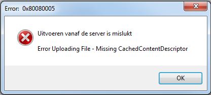

Windchill Desktop Integration Upload error
Is there anyone who can help me?
I get the following error when I upload an word document using desktop intergration.
I working with Windchill PDMLink 9.1 Datecode M050, Office 2010 (32 bits).
Operating system Windows 7

Two possibly related knowledge base articles (if you have maintenance):
https://support.ptc.com/appserver/cs/view/solution.jsp?n=CS22782
Reported to R&D as SPR 2073079
  • Not reproducible beginning with Windchill PDMLink 9.1 M070
  • For Windchill PDMLink10.2 M020 error above was displayed, but it was found that that it was pointed to replica with issues
    • Replica was re-installed to resolve
https://support.ptc.com/appserver/cs/view/solution.jsp?n=CS22640
  • Reported to R&D as SPR 2072861
  • Corrected in Windchill PDMLink 9.1 M070 and 10.0 F000

Thanks Tom,
I was afraid for this answer.
We need an upgrade, so I have to live with this error untill we get the upgrade.
