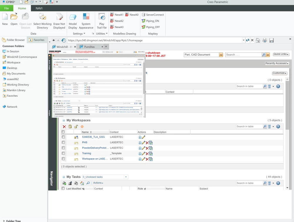

Windchill double small window within Creo 8.
Our company is running Creo 8.0.6.0 with Windchill
Standalone Windchill via Chrome, no problems.
Windchill window on Chrome, laptop computer, laptop display, no problems.
Windchill window on Chrome, laptop computer, extended to second monitor display, display problem.
On the Creo browser (Chrome) There is a second Windchill window appearing atop the first Windchill window.  (See image)
Also, if I am on the laptop screen and I drag the window over to the external monitor, then the problem shows up.
Capture.PNG.

See
Article - CS387234 Embedded browser shown as overlapped (displayed twice) when the display scales on two monitors are different and
Article - CS28315 Common symptoms and resolution of graphics issues in Creo Parametric and Windchill Workgroup Manager
