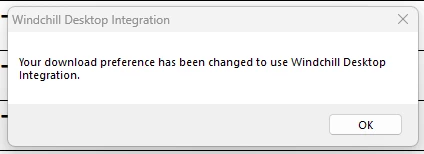

I have a user who wants the download preference to be the basic browser functionality. He sets that preference but when he downloads a part number log he's greeted with this error message. Is there something that needs to be set so this stops happening?

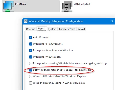

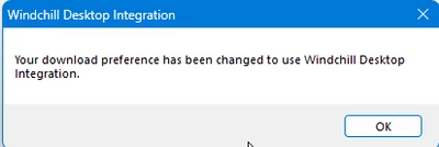

They likely saw this message when they used the desktop integration:
You can change a setting in the integration to stop this from occurring:
Right click on your configuration or view user settings. Uncheck this option and it should stop.
