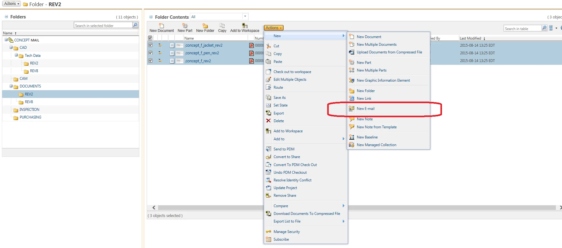

  I recently was requested is there a way to email documents from a WC container out and use client mail service?
I wanted to pick our collective brains first, attached I made concept of how it could work? a NEW Email button?
I notice WC has a email button in Teams containers so the function does exist.
Right now our project leads are downloading files to a network drive so they can gather them up for vendor quotes, I believe this is extra work for them and we have a potential loss of data.
And saving files outside on the network which defeats the purpose of WC. If files are shore on the network drive then who's to say the latest revisions can be?
these files are in PDF formats to represent the drawings.
we can not use desktop integration on our network

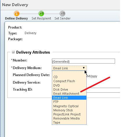

Instead of writing customization to send email with primary content, you can use Packages. You can create  package with require data/documents.  Create delivery and send delivery to users (There are different options available to send delivery)  Windchill will email zip file containing primary content of all document to require user.
Also with the help of package and delivery you can keep record the emails.
Hope it helps !!
Shreyas
Aug 18, 2015 4:10 PM UTC
Package does not work for this instance too many steps and we send out 20 to 40 quotes a day ,
we need a fast way to Send to EMAIL

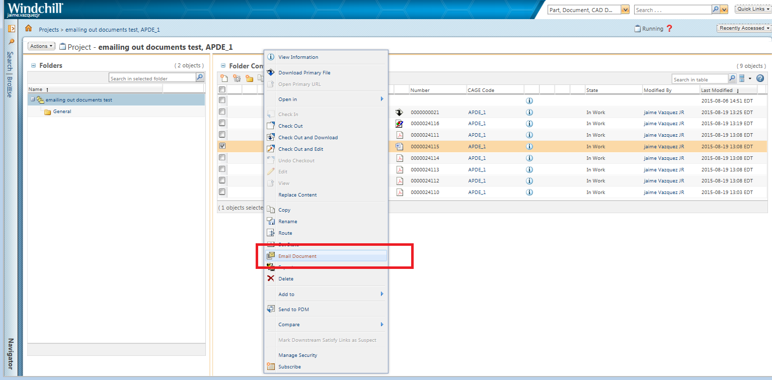

Aug 20, 2015 2:10 PM UTC

Aug 21, 2015 12:57 PM UTC
Jaime,
take a look at this discussion What's New In Windchill 10.2 M010-M030 for Document Management
We are expecting a CPS for 10.2 M030 to fix the issue.
Marco
