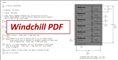

Mar 21, 2023 7:00 PM UTC
Windchill generated PDF
we are using Windchill Release: 11.0 M030-CPS16

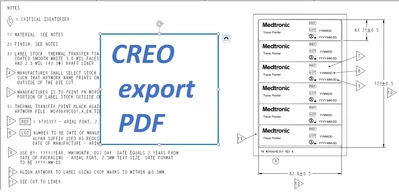

having issues Creo drawings with shaded views with decals (images *.png)
windchill generates PDF with views grey shaded - Creo export pdf works fine
any ideas?
thanks,
Rich

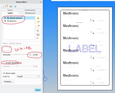

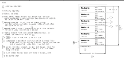

Mar 22, 2023 3:49 PM UTC
thanks,
I checked our recipe file settings for Windchill PDF output and confirmed they match my Creo PDF settings
I found if I "max white lighting" in Creo part - Windchill PDF outputs correctly for dwg
Windchill PDF
not sure if this best approach but it worked......

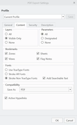

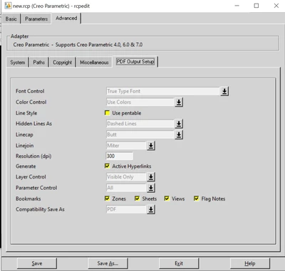

Mar 22, 2023 4:43 AM UTC
Open your drawing file in Creo and go to the export window, then check with the settings that your Creo is using for exporting pdf. And now you can compare those settings with recipe pdf output settings. Specially under content tab from creo PDF Export settings > Fonts and make sure you are using the same options in font control setting from recipe file as well.
My setting in screen shot is not matching, but I am providing it just to get directions.
