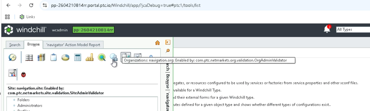

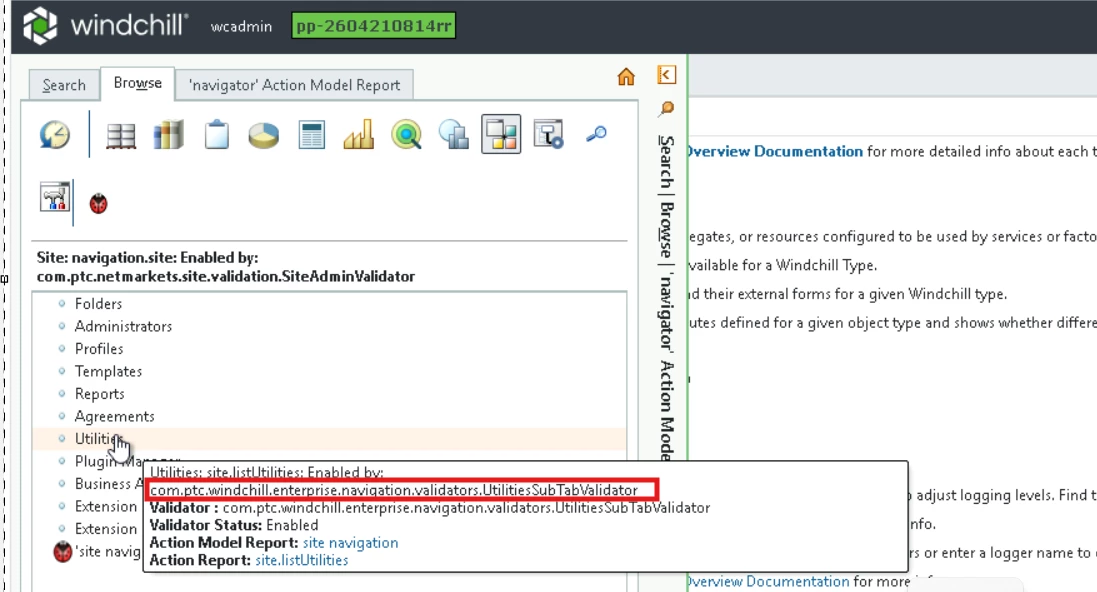

its not that way, the policy admin has visibility check on the top of permission ,if you are not Admin Org/Utilities page hidden by validators :
This requires UI custo.
