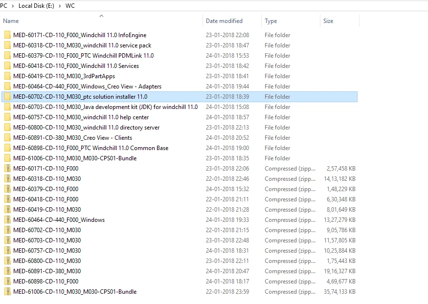

Hi @mkh
  • Windows 10 is unsupported even in "Development and Test Systems"
  • Please don't rename your folder source like that "MED-60703-CD-110_M030_Java development kit (JDK) for windchill 11.0" , my own but PTC hate that ( extra space, special character etc.. )
  • Please attach full log
I think the PSI doesn't detect Windows 10, because the first error is UNIX Path
ERROR 2018-01-29 14:58:11 - java.io.IOException: Cannot run program "/usr/local/bin\cscript.exe"
mkh1-VisitorAuthor
Jan 29, 2018 1:34 PM UTC
Hi @Vincent-Kulak
Thanks for replying. Please find attached the log.
Have renamed just to make things easy and avoid confusion- i have kept the extracted and zipped files in the same place. Have a look: 2018-01-29 19_03_46-WC.png
Awaiting your reply!

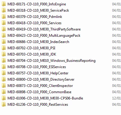

Jan 29, 2018 2:14 PM UTC
The running command used by PSI is incorrect
Exemple in my log:
INFO 2017-01-09 14:38:47 - Running: C:\Windows\system32\cscript.exe //E:vbscript etc...
Yours:
INFO 2018-01-29 14:58:11 - Running: /usr/local/bin\cscript.exe //E:vbscript
I think this is platform related, You can try same configuration on Virtual machine ( Windows 7/8 )
FYI i manage my sources like this:Capture.PNG
