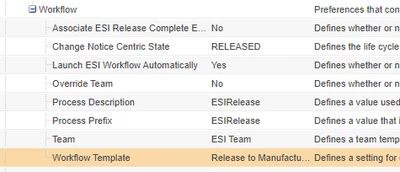

I would think ESI module would be required to be installed. Do you have this preference at your Site level? ESI - Settings - Workflow - Workflow Template?
This is where the ESI workflow would be configured:
