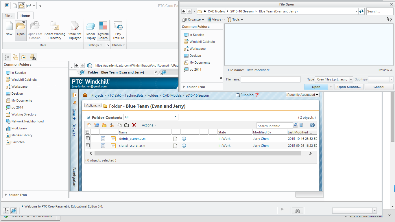

I am using Creo Parametric Educational 3.0 and Windchill 10.2 M020.
When I open Windchill in Creo Parametric from the open button in the home screen, it will not show any files on Windchill. It will show the folders. Is there any way to fix this and show the files on Windchill? Thanks.

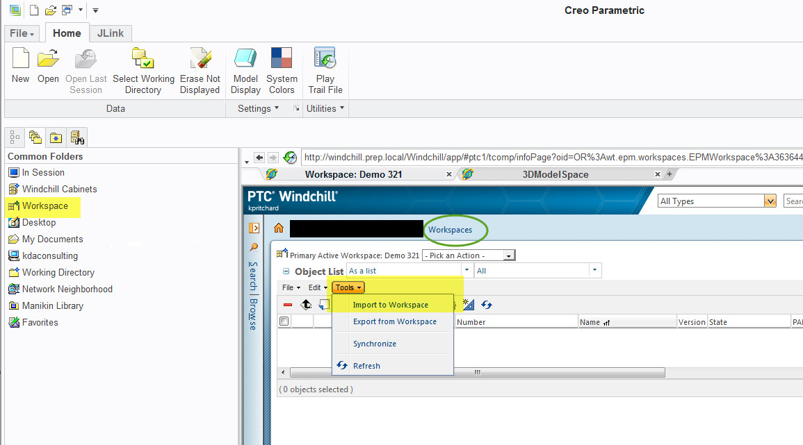

It looks the Object types are WTDocuments and not CAD Documents, which would explain why Creo can't see the files to Open.  CAD Documents are a different data type than WTDocuments.  If you have access, I'd suggest reading through Using Creo Parametric with Windchill
CAD Documents need to be Checked In from a Workspace or if there are a very large number of files and Administrator can load them in using a bulk loader.  If we're talking about  a file count in the 100's I would suggest importing into your Workspace (see below) then Checking them in so they are visible to others as CAD Documents
