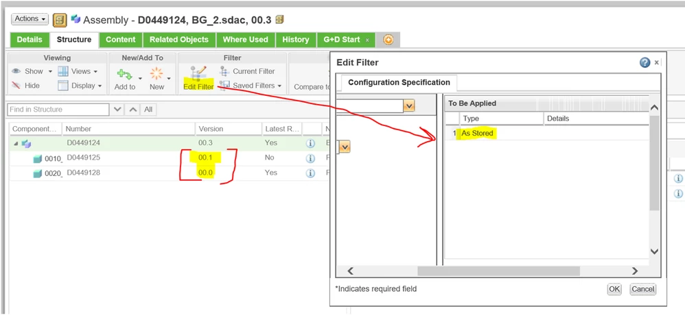

I am facing one strange issue is windchill functional behavior with some data. Sometime its behave correct sometime not.
When i am loading or opening assembly in windchill, components of the assembly is not displaying correct version/iteration. Filter AS-Stored is already applied on assembly but the displayed components are not as per applied filler and as soon as i open the filter window and click on OK as-stored filter get applied and then components started displaying correct version.
Note: happing with some data sometime.
Assembly after loading displaying 00.1 version as highlighted. Also you can see filter is already set to AS-STORED, but components display is wrong.
Wrong iteration display filter is already setWrong iteration display filter is already set

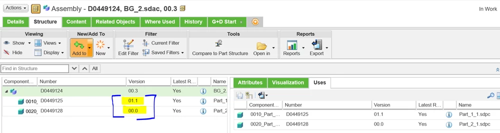

Now i clicked on ok button from previous filter window and components set to as-stored and started display correct version 01.1.

Don't use "Edit Filter' to see what is currently applied.
When you see the issue, click the button "Current Filter" to confirm what is actually applied. Make sure that "As-stored" is applied as you are expecting.
Windchill will sometimes remember your filter selection from a previous page or view. Keep that in mind in case you sometimes change it.
HelesicPetr
December 3, 2024
And sometimes it load default structure instead of filter setting. The setting has to be applied again.
Sometimes it happens. It can be based on a browser type, cookies memory and so on. Usually refresh the page with CTR:+F5 solves the issue.
