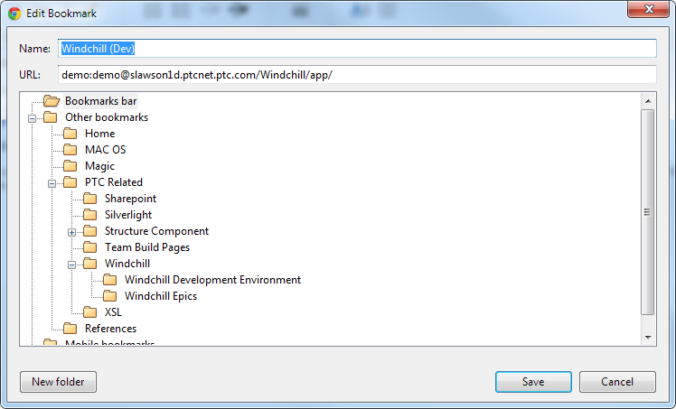

This is a neat trick I use when developing.
In Windchill it is difficult to 'logout' and then login as another user. To get around this create two browser bookmarks with url format as:
http://username1:password1@windchill-server.ptcnet.ptc.com/Windchill/app/
http://username2:password2@windchill-server.ptcnet.ptc.com/Windchill/app/
This adds the username and password into the http request, so the user is not prompted. This has the added benefit that you can jump user easily in Windchill if you store the url as a bookmark.
This is really useful for demos!
This is an example of one of my bookmarks:

colon (:) between username and password, not period (.)

I think you need to change the address after the @ symbol to the address of your server.
Apr 19, 2013 12:26 PM UTC
ya i got it now.
i was trying this in Internet expolrer. but it does not work in IE.
It works in mozilla firefox.

Nice trick. But why dont you use New Session to login in to different user in IE? or Multiple profiles in Chrome?
May 21, 2013 3:49 PM UTC
I also found this works in Chrome but not in IE. Works nice, thanks.
