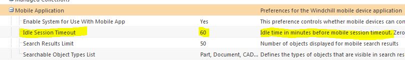

Did you ever get this to work? I'm getting the same error you are when trying to connect to our Windchill PDMLink 10.0 M030 server. I don't even see the "Windchill Mobile Application" option under the Preference Managment menu when connected as the site admin.

windchill wt.load.LoadFromFile -d <windchillHome>\loadFiles\mobile\mobilePreferences.xml creates the site preference "Mobile Application / Enable System for Use With Mobile App". Enable it!
With this 2 steps it works.
Probably upgrade to Windchill M030 didn't load this xml.
Mar 19, 2012 3:53 PM UTC
Nicola,
That fixed it. Thanks!

I was able to get configure and see the Mobile app option on Windchill preference manager. However, when I configure the mobile app, it time out and won't display the information
Mar 20, 2012 8:14 PM UTC
So you've enabled the system for use with the mobile app, are able to configure the app for your server, login & connect? What are you seeing when you connect via the App? When you say "time out" do you mean some sort of immediate disconnect? There is a setting under the Mobile Applications preferences where you enabled it but the default setting is 60 minutes & that just forces you to re-enter your password after the set time, it doesn't boot your out of the app or leave you in but functionless. What are the symptomes you're seeing?
