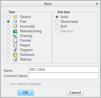

In our current system, when making a new model, the CAD users are used to rigorously filling out the Name (as per company numbering scheme) but they leave the "Common Name" blank:
So then the hidden model parameter PTC_COMMON_NAME takes on the value of filename, that is, "Name" in the above dialog box.
Then upon saving to workspace, the Windchill "Name" of the object takes on the value of PTC_COMMON_NAME and so becomes the same as filename.  When object is uploaded to the server, our Windchill auto-assigns it the number that is the same as the filename.  So now, when browsing our database, I often end up looking at tables that have 2 or 3 columns filled with the same information: File Name = 995-13004.prt; Number = 995-13004.PRT; Name = 995-13004.prt.

I guess this whole PART_NAME is legacy issue - maybe from Pro/Intralink days before my time?  I will try the solution in which our standard title block will have &PTC_COMMON_NAME in the "Part Name" box instead of that designated &PART_NAME model parameter.
Still, I think one problem will remain:
Once the part is saved and uploaded to the server, its parameter PTC_COMMON_NAME is no longer editable (double-clicking a table cell that contains &PTC_COMMON_NAME results in the familiar prompt to "Enter value for PTC_COMMON_NAME", but entering a different value brings a rather unhelpful error message in the status bar "ERROR: Relation has an error. Please re-enter:")  I am guessing that is actually because the PTC_COMMON_NAME parameter became locked by Windchill.
Anyway, I was not looking to back-drive the WC filename or WC Number - those need to be unique.  But I don't see why, in principle, WC Name can't be changed from the Creo side.
In my opinion, what should happen is that PTC_COMMON_NAME remains editable; if it's changed, then upon check-in, Windchill renames the WC Name of the CAD object.
