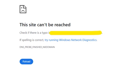

Windchill not working after setting Windchill DNS alias for URL
These are the steps I followed to set DNS alias name for URL.
1. Disabled the SSO configuration
2. Set the DNS alias name in wt.server.codebase property by
xconfmanager -s "wt.server.codebase=$(wt.webserver.protocol)://myalias.domain.com/$(wt.webapp.name)" -t codebase/wt.properties -p
Property defined in site.xconf file
3. CERT file has DNS alias name and imported to keystore.
4. Enabled sso.
5. After this unable access new DNS alias name site URL (https://newDNSaliasName.com).
It is not showing It Works.... and unable to generate metadata.
Windchill page Shows
Please let me know if I'm missing something.
FYI: followed Article CS387851
Thanks.

That may work, but it is not correct according to PTC's documentation.
https://support.ptc.com/help/windchill/r13.1.0.0/en/index.html#page/Windchill_Help_Center/WCSysAdminWCConsiderSecureInfrastructure/WCConsiderSecureInfrastructure_ServerHostnameProp.html
"The host name used to connect to the Windchill instance is stored in the wt.rmi.server.hostname property (which is initially set during installation as the value provided for the web server DNS host name). This host name is used by all clients that are not JMX clients."
wt.server.codebase should not have been touched.  Just change wt.rmi.server.hostname.
xconfmanager --reset wt.server.codebase
xconfmanager -t codebase/wt.properties -s wt.rmi.server.hostname={FQDN} -p

Do you update the ServerName to the new DNS in httpd.conf under <HTTPServer>/conf?
May 27, 2025 11:33 AM UTC
If you are switching all of Windchill to an alias name, at a minimum you have to...
  • Modify the Repository table in the database
  • Change the ServerName in Apache
  • Update the wt.rmi.server.hostname in Windchill
  • Rehost your LDAP JNDI Adapter(s).
That last one is particularly painful when done manually.
The way you should do all of this is with PTC's rehosting script.  It is tedious to configure but will handle all of these issues and more.
If you are sure that Apache is your only issue, just update it from a Windchill shell.
ant -f %wt_home%\..\httpserver\config.xml reconfigure -DServerName=server.company.com
