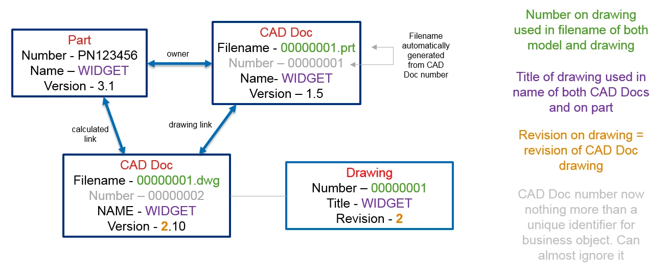

Tom
Our current policy is what you describe as your aim, and I’m thinking hard about moving away from that completely.
Our system is completely overrun with examples where the numbers don’t match and it’s really hard to police. You might have well behaved process obsessed users so it’s not such a problem in your case. Currently I cannot trust with enough certainty when looking at the Windchill part number that the describing CAD Doc number matches or the filename matches. As for whether the number displayed on the drawing is correct you have to trust your designers and your design process. Windchill cannot validate this.
If you really manage your BoMs in Windchill, the ultimate truth about which document describes which part is defined by relationships between objects not whether the numbers match. Matching numbers are very familiar and reassuring to users but sometimes they tell a lie.
We are also considering using different numbers for parts/items and documents. I would love to hear from others who have experience for or against this approach.
Auto number parts and CAD Docs = nothing to manually keep in sync. – see attached
To support this way of working I envisage some work on custom BoM reporting. If the download/view link for the describing document is right next to the part number, there is no requirement to know anything but the part number in order to get the drawing.

Interesting scheme, Darren. Our situation (I don't have a nice picture yet), mostly driven from historical reasons:
  • in ERP
    • Article (or Part): PartNumber - PartDescription
    • Technical Drawing: DocumentNumber - DocumentDescription
  • in Winchill
    • WTPart: ERP-PartNumber - ERP-PartDescription
    • 3D CAD model: advised to have filename=number=name, PartNumber is an attribute!!
    • 2D CAD drawing: advised to have filename=number=name, DocNumber is an attribute!!
Regards, Hugo.
<< ProE WF5 - PDMLink 10.1 M040>>
