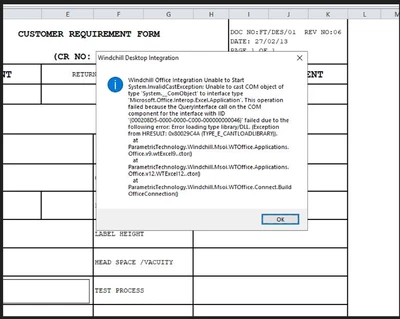

windchill office integration unable to start
I am using Windchill PDMLink Release 11.1 and Datecode with CPS M020 CPS30
when we try to open the WTDocument primary content in excel, "windchill office integration unable to start" this error is persisting.
Here are the errors that I faced
7-Bedrock
Mar 1, 2024 12:41 PM UTC
PFA for error message
