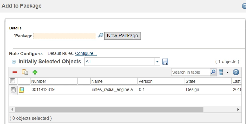

Hello all, we are starting to use Packages - primarily to start for collecting data to be provided to vendors for direct use, not for import to another Windchill system.
Just experimenting a bit today to see if we can include files on the Content/Attachments table of CAD Documents. Don't immediately see a way to do this, so asking the community - is there a way to include attachment files in a package to which a CAD Document is added?
Note: We use Attachments extensively, partly due to publishing using publish rules that take advantage of the "additional_files" functionality.
thanks in advance.

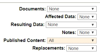

    We use attachments as well as part of publishing and they regularly get added to the packages.
    First: make sure that on the collection rules you configure that secondary content is in fact included
    Make sure you have a package selected (or create a new package) and then select "Configure"Make sure you have a package selected (or create a new package) and then select "Configure"This is on the right-hand size. As long as published content is set to all, the package will collect all secondary information.This is on the right-hand size. As long as published content is set to all, the package will collect all secondary information.
    Second: when locking the package, make sure to include the file extensions you'd like to be included.
