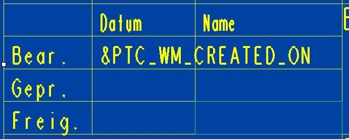

Windchill Parameters for Approved an Checked Drawings
I hope you can help me.
I'm looking for the appropriate parameters to note on the drawing who checked and approved the drawing and when it was made.
I have already found the parameter for the creator (&PTC_WM_CREATED_ON and &PTC_WM_CREATED_BY) and am now looking for the parameters mentined above.
thank you in advance.
Apr 3, 2019 4:11 PM UTC
There are none.
We carry those as drawing parameters only using a restricted _params.txt file to limit the names that may be used.
FLH_ACE1-VisitorAuthor
Apr 4, 2019 5:57 AM UTC
Okay.
I think we will just let it open to let them put their names and dates inside.
Thanks for yoru fast supply.
