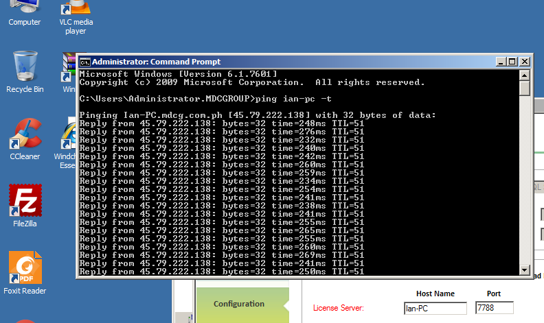

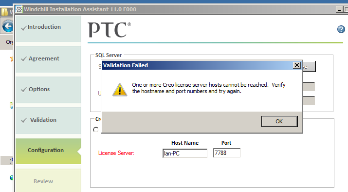

In the installation process on PDME my validation for Creo publisher License Server (Single License Server) was FAILED.
But I can ping my server license.
My firewall for both servers are also OFF. How come the verification for my creo server license become failed? What is the cause and how to troubleshoot this?

Is the license server running? Could you telnet to port 7788 on license server? or net state -aon | find "7788" on the license server returns any results
