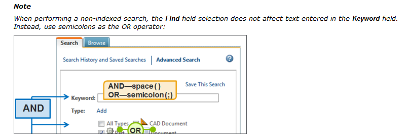

From the help files.
If you type in electronics;board (no spaces) it will return nothing.  Putting a space after the semicolon does have results.
LawrenceS18-OpalAuthor
18-Opal
Jan 20, 2017 7:20 PM UTC
Steve Galayda‌,
I get less results when I use the semicolon (without a space I get none, and with a space I get some but less).  So this tells me that the semicolon method is not working.
