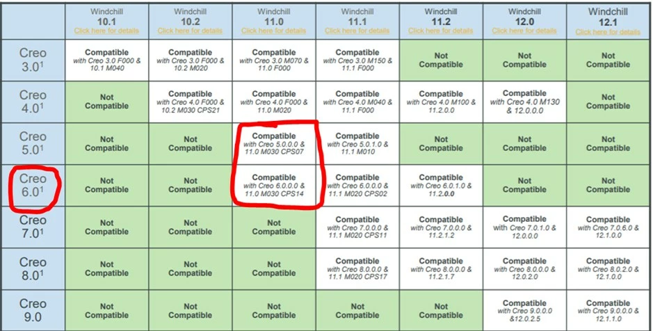

I am using Windchill PDMLink Release 11.0 and Datecode with CPS M030-CPS11
Hi, we currently have Windchill 11.0 M030-CPS11 with CREO 4.0 M050.
We are looking to upgrade to CREO 6.
My question is therefore whether Windchill 11.0 M030-CPS11 is compatible with CREO 6.

I'm pretty sure that the 11.0 CPS11 is not compatible with CREO 6 but I believe that the newest CPS could be compatible. for Windchill 11.0 but it is not searchable because the support for wch 11.0 has ended.
Our customer is on newer Wch 11.1 CPS14 and it is also not compatible with Creo6, but a newer CPS is compatible.
anyway I would advice to upgrade Windchill to new version.

Thanks PetrH. A colleague was able to find the attached matrix which suggests CPS14 is (should be) compatible with Creo 6 so concerning if your customer found it's not?
We're not able to upgrade Windchill yet beyond v11, but looking for a way to work with Creo 6 in the short-term.

So you need to update to Windchill 11.0 CPS14
Our customer is on Windchill 11.1 CPS14 it is different version then you are on.
